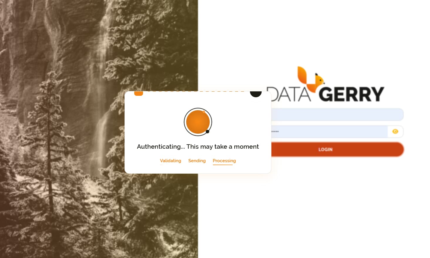

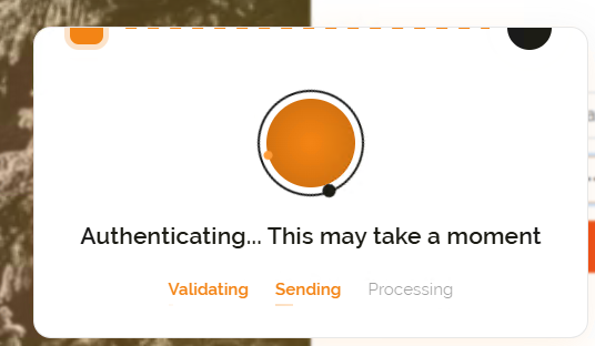

what is required? Where to look?
The problem is after the update, when entering the correct login and password, the system loads for a long time, and then crashes.
It works on local authorization.

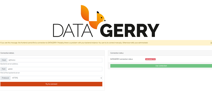

Me and my colleague woulf like to add the following since it seems to be related to this issue. We are also using nginx.

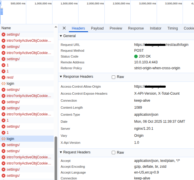

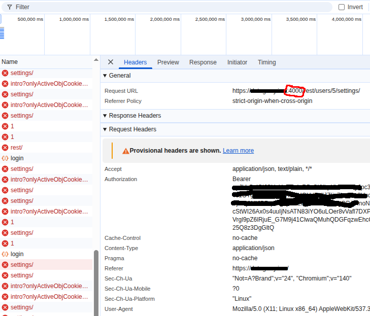

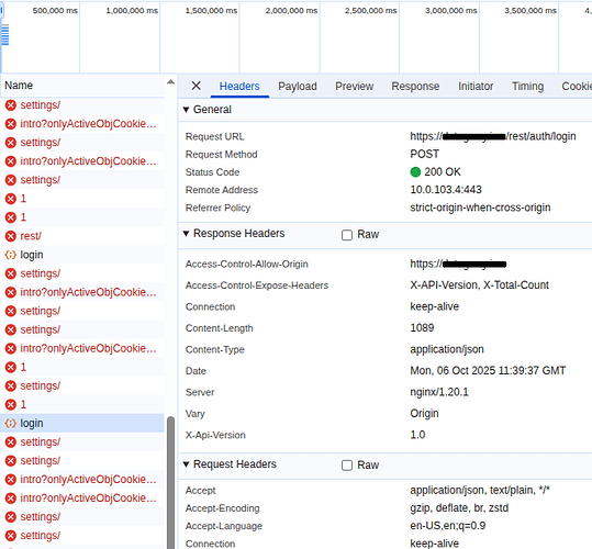

The whole thing is stranger than it seems. I have two different browsers on the same computer, and one works fine. In the other browser(chromium), the login succeeds, but subsequent queries aren’t being directed to the standard port 443. Instead, they’re going to port 4000.
Login request
Settings request
Hello, if you want to workaround this bug temporarily for your user, make sure to open the developer console (F12), go to the “Application” tab, then “Local storage”, choose the item for your host and in the key value store, update the value of the connection key to your hostname but without the port number (4000).
Make sure to keep the double quotes.
I am pretty sure that the devs reading this post will then have a pretty good idea what to change in the code in order to not force saving the port 4000 into the localstorage on proxied configurations running e.g. on full https.
We’re running datagerry in kubernetes on https, and those users, which had the right port-less value stored in their localstorage were able to login correctly, while others who did not have previous sessions, failed due to the API being called via https://hostname:4000 instead of the https://hostname. This makes the bug hard to detect, because it fails typically only for the newbies.
That with the port 4000 looks like a bigger problem, that is not bound to LDAP. We have the same issue: Issue with Datagerry on Kubernetes with Envoy – Redirect to Port 4000 . We found a workaround by patching the hard-coded port values in the code and build the container ourselves. Maybe it can help you too, even if an upstream fix is clearly needed here.
