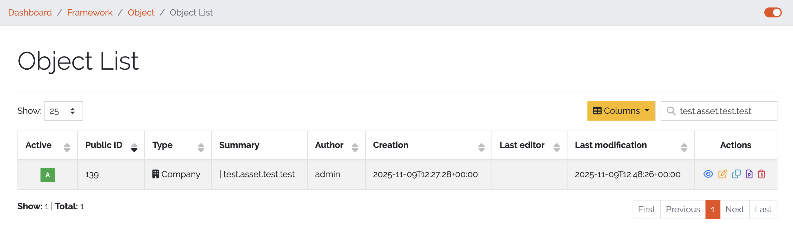

As you can see in the screenshot, it’s working fine on my end. Could you give me the steps you took leading up to the issue so I can try to regenerate it on my side?

Hey @abdullah-khalid
can you try adding another .test after your so you searching for test.asset.test.test
Then it crashes on my System with Error 400

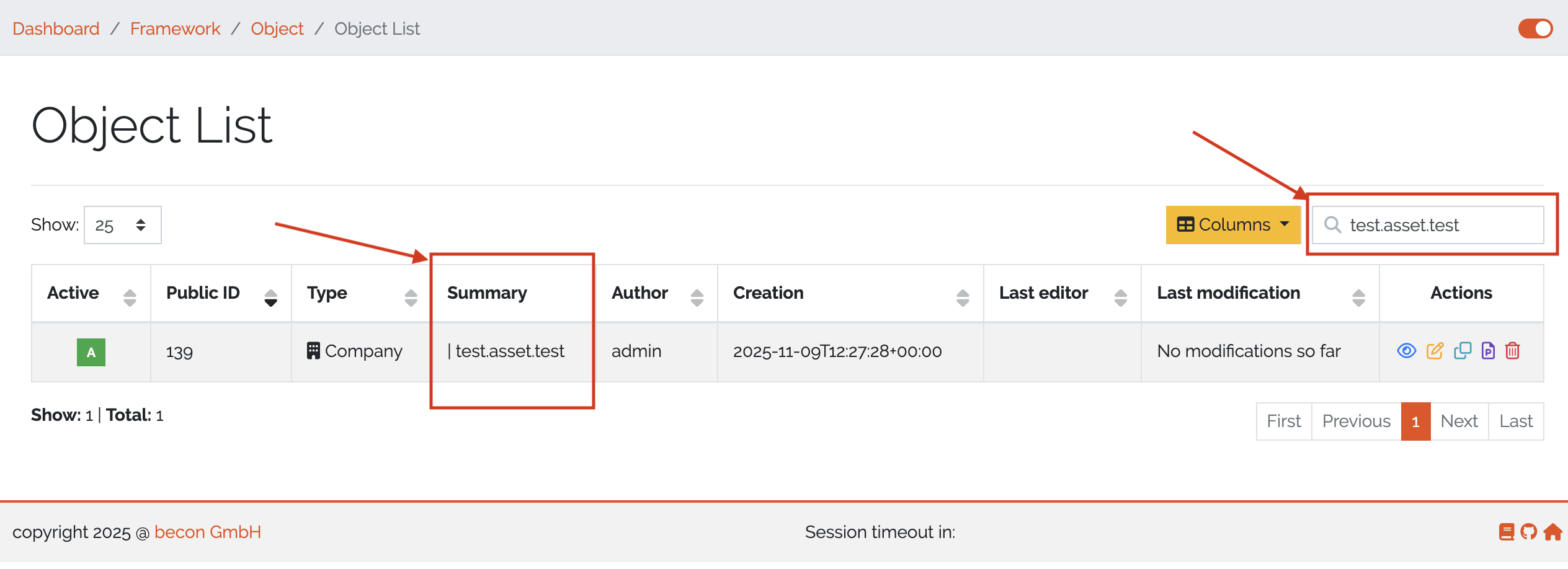

Hi @Daniel,
I just tested using both a hyphen and a dot (in two separate screenshots), and both are working fine for me. :thinking: It’s strange it doesn’t work on your side.
